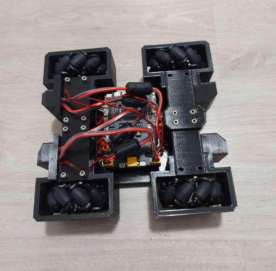

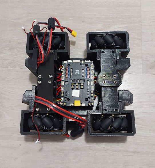

We are working on a mecanum base with a lidar positioned quite low to hit the table edges for localization (based on my experience with vigibot). Counter-axes are added at the wheel level in the protective fairing to relieve the motor reducers a bit. The front motor train is mounted on a pivot linkage to keep all four wheels in perfect contact with the ground.
Some photos:

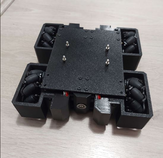

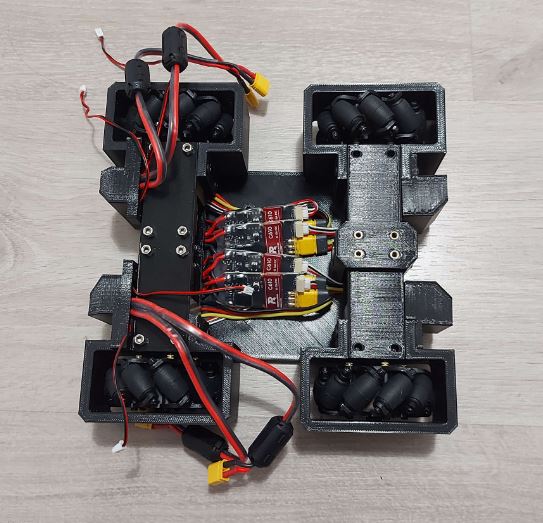

Assembled base from the top:

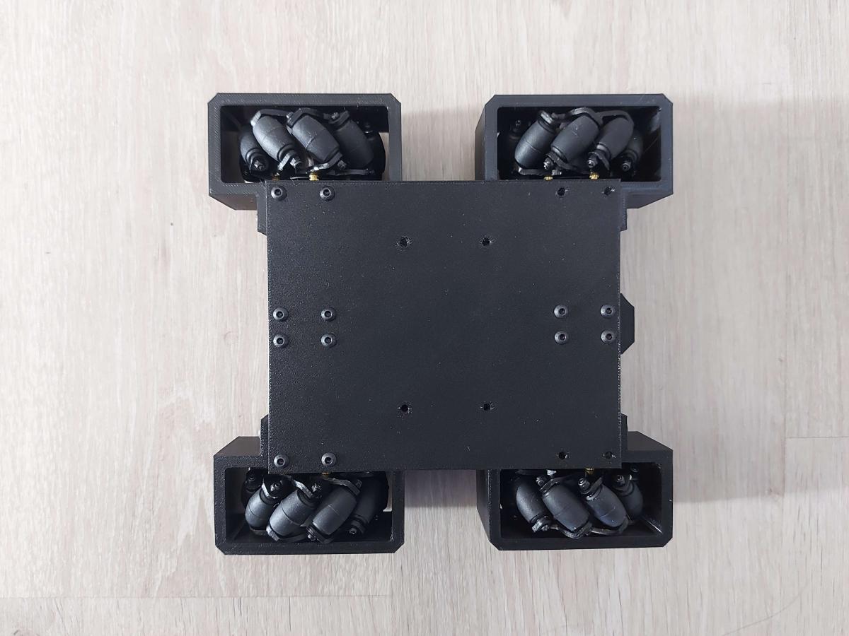

Assembled base from the front:

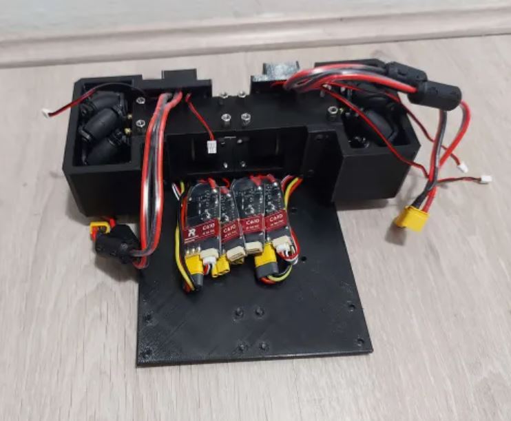

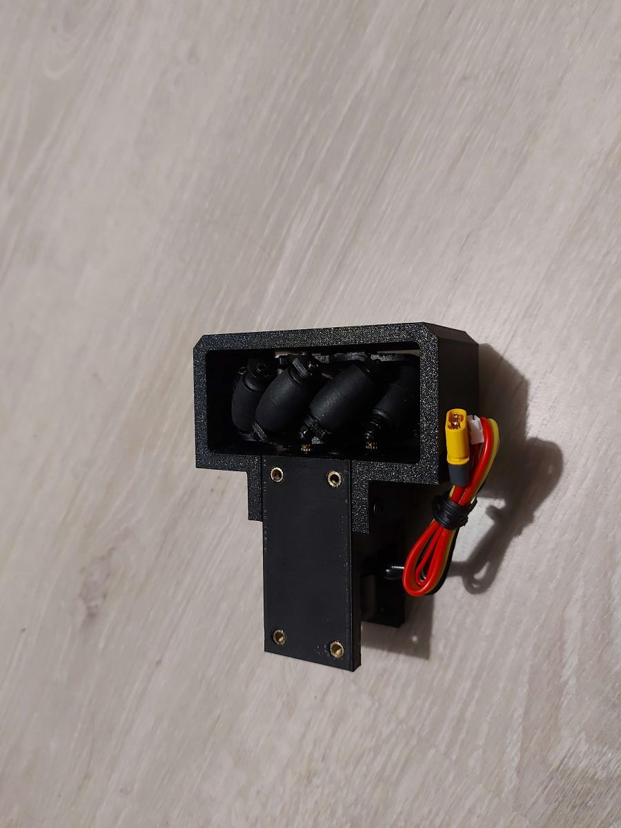

Highlight of the front train pivot without wheels:

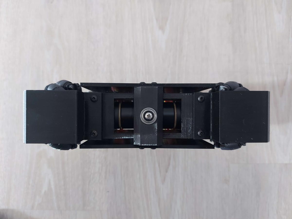

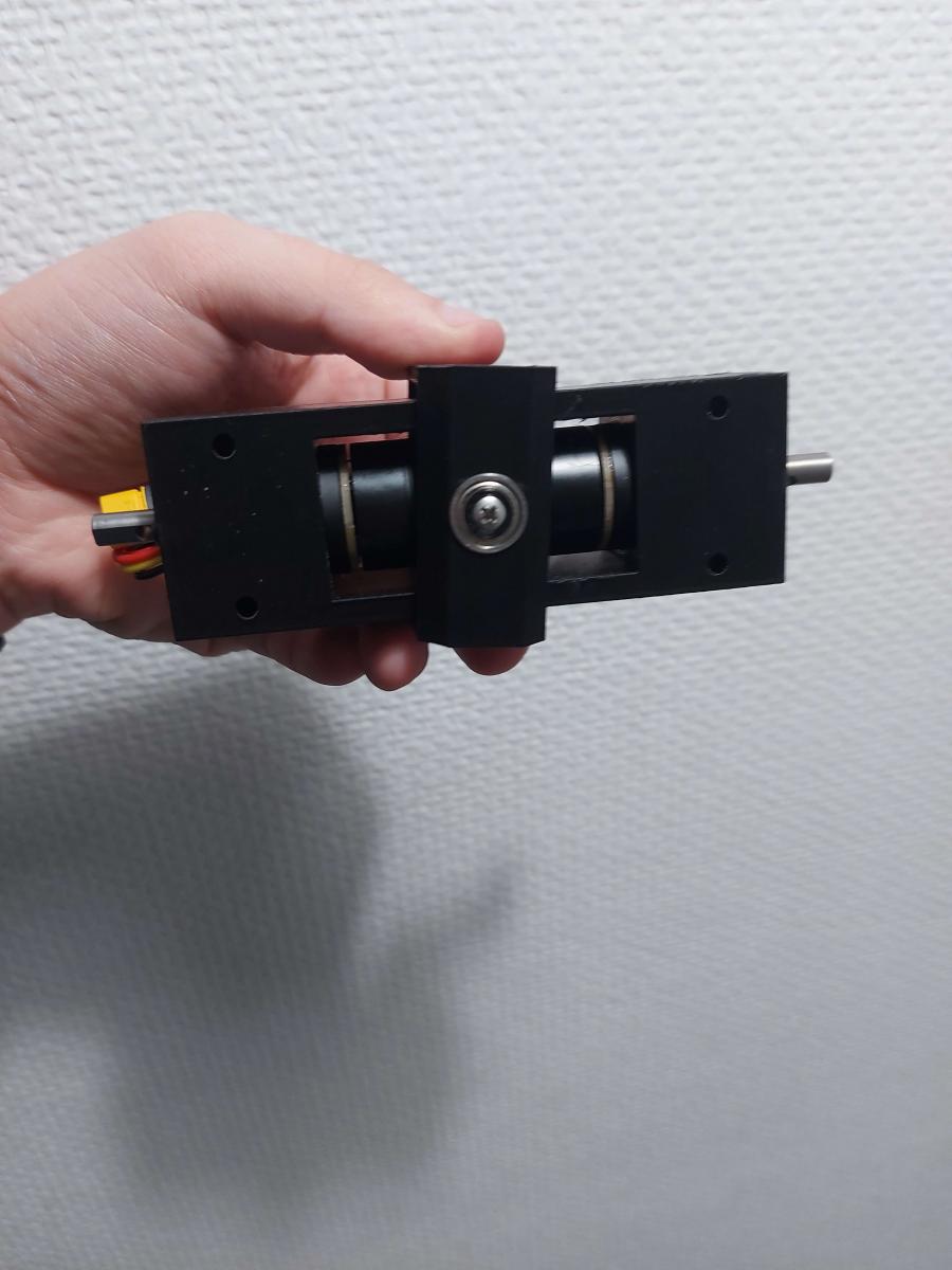

Top view of the motor support integrating bearings and counter-axis in the wheel fairing:

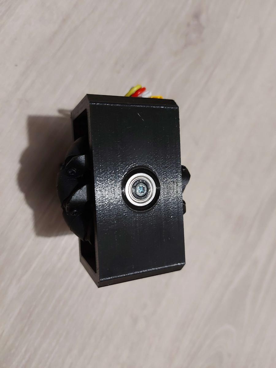

Front view of the motor support integrating bearings and counter-axis in the wheel fairing:
For this mecanum base, we are using:
Several 3D-printed parts (PETG), (the files will be shared) and plenty of screws and fasteners

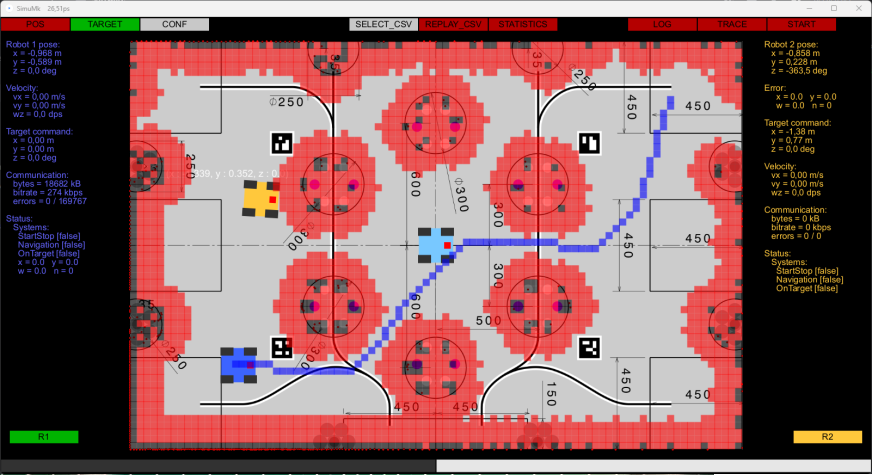

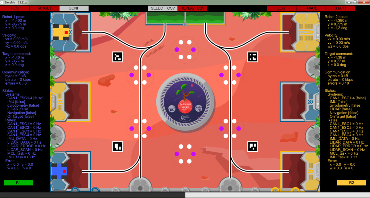

We have implemented a visualization tool "from above" that allows, among other things, controlling the robot and logging data. This visualization tool, developed in Java with Processing, can connect directly to the robot during tests or to other simulation tools that have also been developed.
Here's what the tool looks like at the moment:
This tool will be shared with various examples on the visualization tool's Git :  (Basic examples have already been shared, with the idea of providing building blocks so that everyone can develop the tool that suits them from examples)

Firstly, we continue to refine our mecanum base.
Here is how the current version of the base is assembled and wired:
While we work on the final version of the robot base, we are also improving the localization algorithm and conducting movement tests with the prototype base.

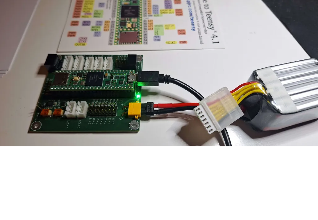

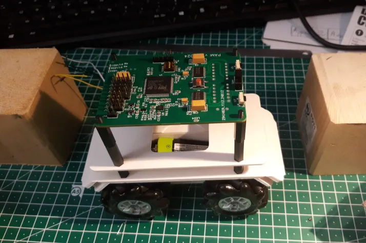

We made some pcb:
=> A board based on teensy 4.1 integrating quite a few UART sockets, a CAN socket, and electronics to control feetech motors.

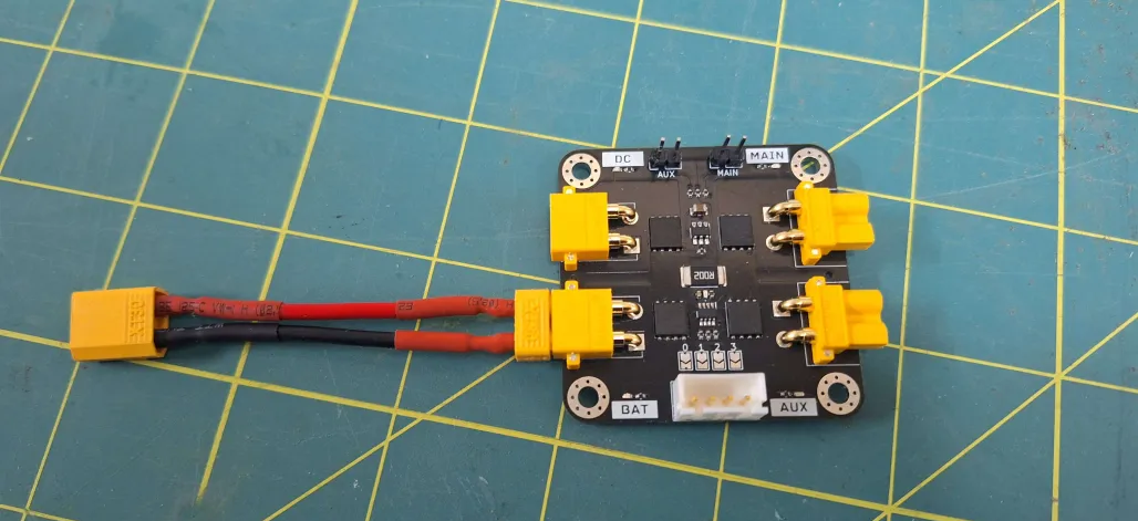

=> A card for the robot's power supply integrating enough to connect an On Off button, an emergency stop button, the battery and an external power supply, as well as a current and voltage sensor.
=> The PAMI card which allows you to control 4 DC motors with encoder and which integrates, among other things, an IMU. ( You can also see the current state of the Pami prototype)
We have also made progress on the path planning of the robots with the implementation of an A* algorithm on an occupancy grid and we display the result on our visualisation tool.

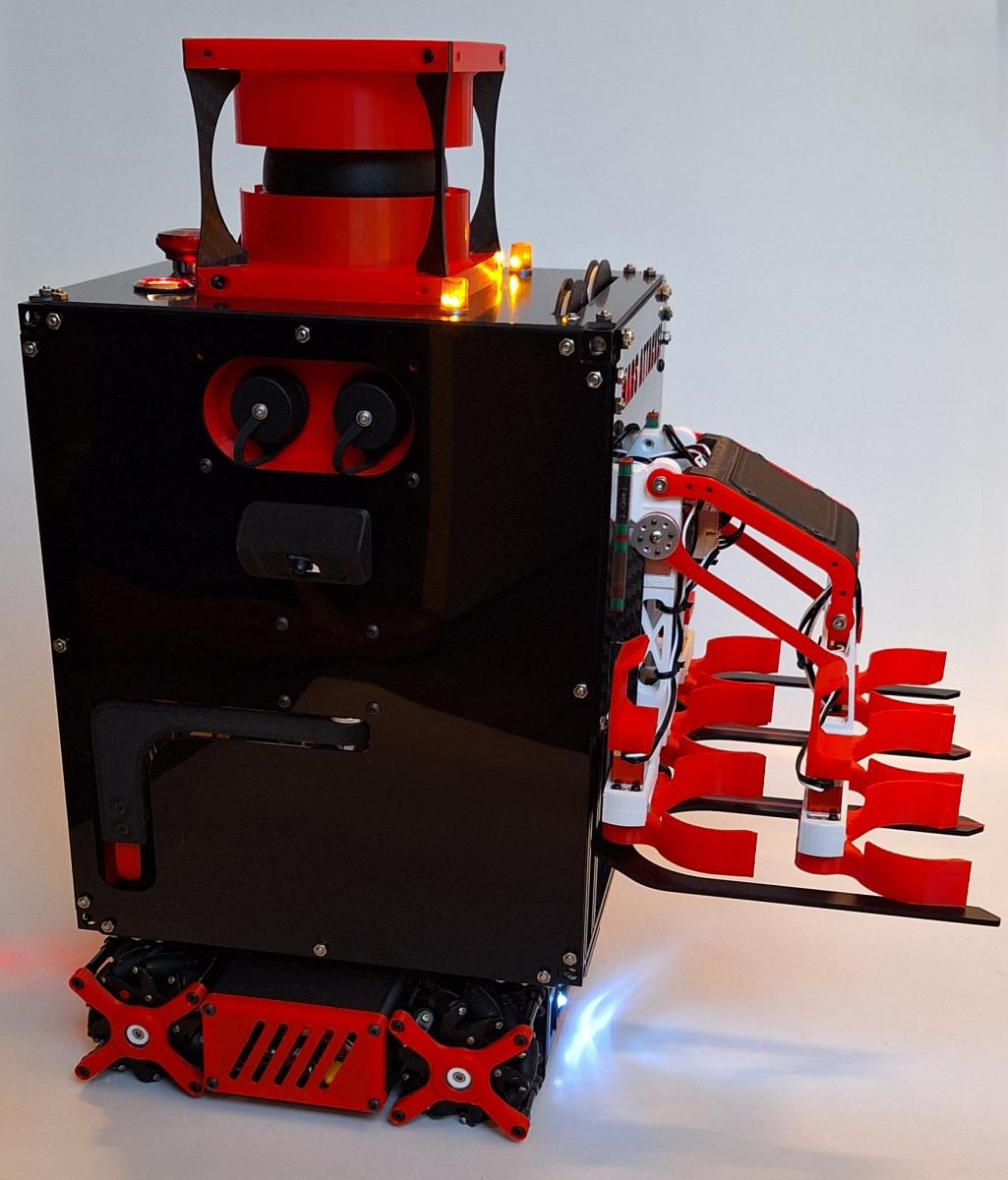

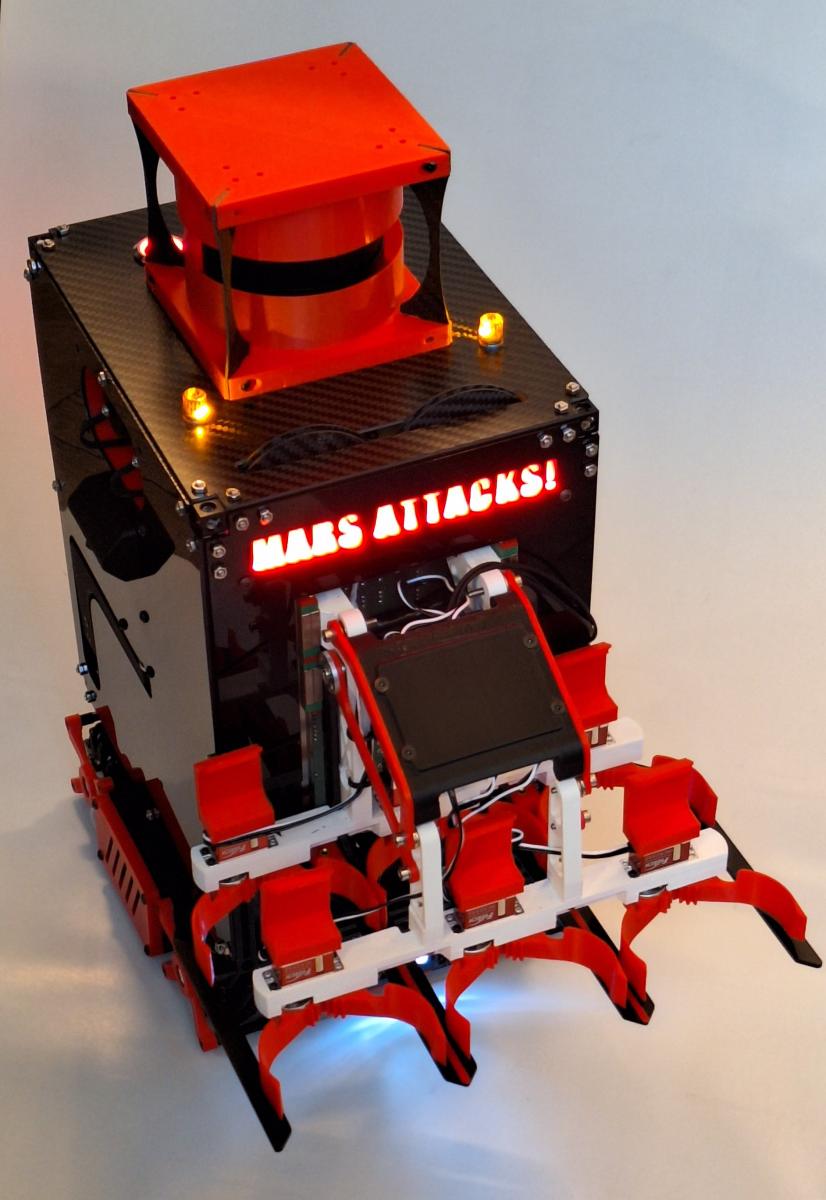

Here's a sneak peek of the first version of our technical poster:

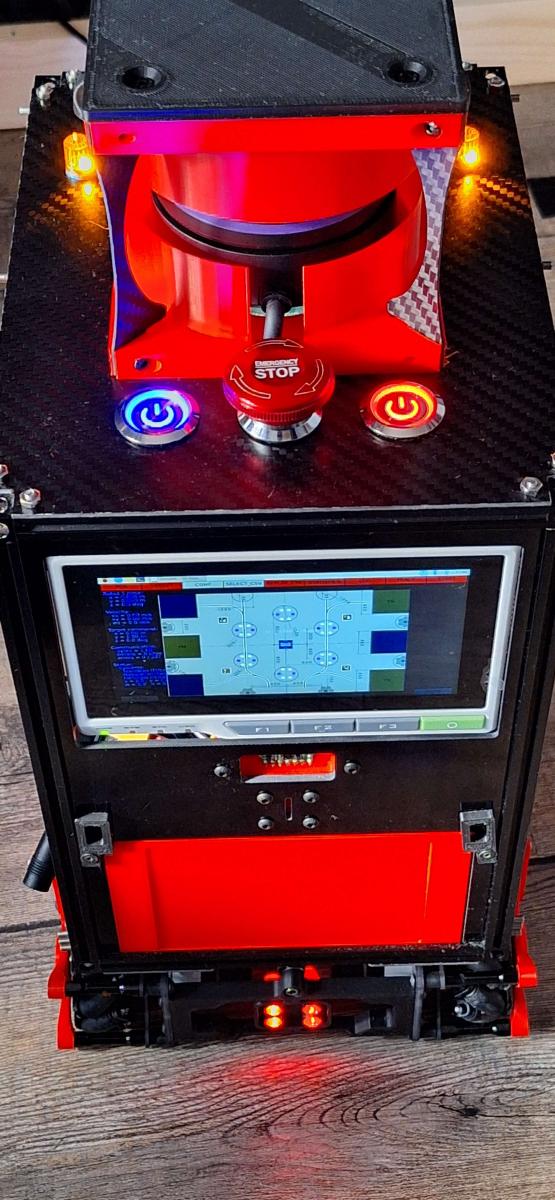

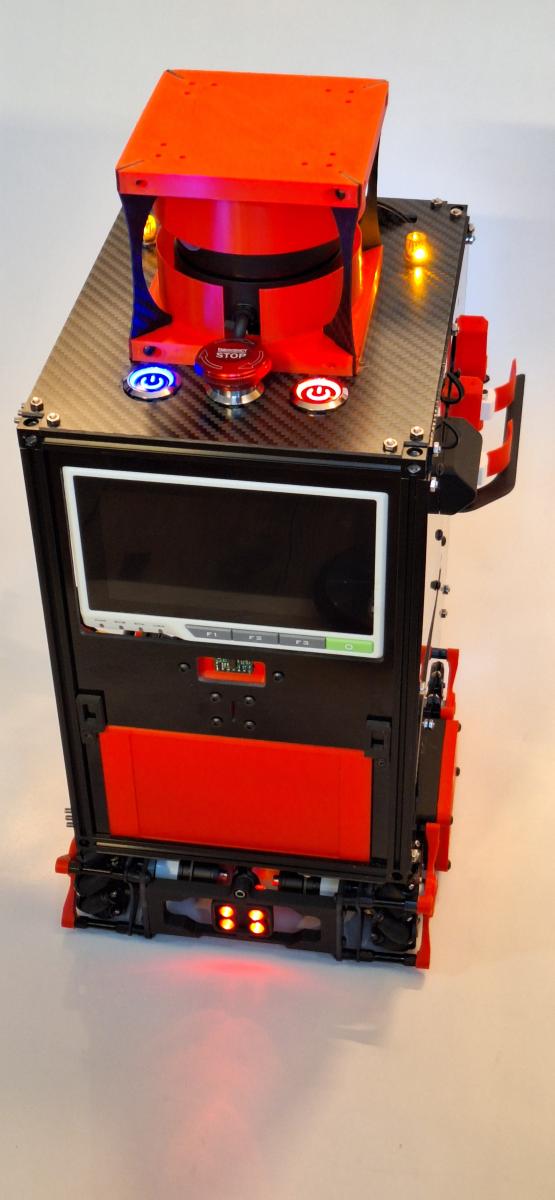

The bulk of the main robot's mechanics is okay, although there are still a few points to review/improve :)
Attached are a few more images:
At the back, there's the screen displaying the visualization tool and allowing selection of color and starting position =)

Posté 24 avril 2024 - 06:59
That is one fine looking robot!
